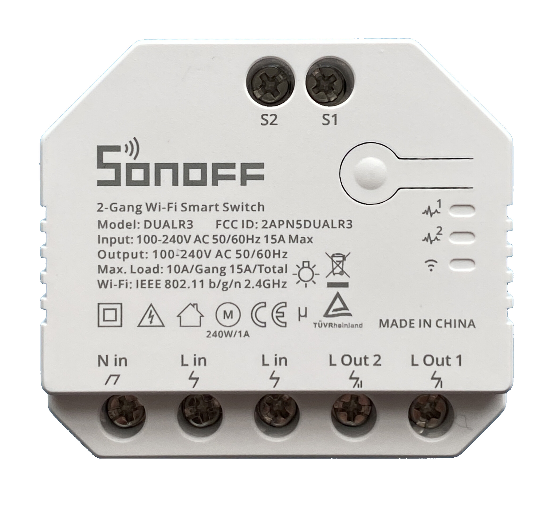

Van de week de nieuwe Sonoff DualR3 binnen gekregen en heb er gisterenavond mee kunnen spelen.
Na wat onderzoek zojuist de config geschreven voor esphome en werken!
Config:
substitutions: devicename: sonoff\_dualr3 long\_devicename: Sonoff DualR3 esphome: name: $devicename platform: ESP32 board: esp32dev wifi: ssid: !secret esphome\_wifi\_ssid password: !secret esphome\_wifi\_password power\_save\_mode: light ap: ssid: $devicename password: !secret esphome\_ap\_password captive\_portal: api: password: !secret esphome\_api\_password ota: password: !secret esphome\_ota\_password web\_server: port: 80 logger: baud\_rate: 0 # remove # below to enable ble tracking #esp32\_ble\_tracker: uart: rx\_pin: RX baud\_rate: 4800 sensor: - platform: wifi\_signal name: "WiFi Signal $long\_devicename" update\_interval: 60s # - platform: cse7766 #The actual chip on the DualR3 is a CSE7761, no driver available yet! # update\_interval: 5s # current: # name: "$long\_devicename Current" # voltage: # name: "$long\_devicename Voltage" # power: # name: "$long\_devicename Power" # id: power # on\_value\_range: # - above: 1.0 # then: # - logger.log: "$long\_devicename Power above 1.0A" # - below: 1.0 # then: # - logger.log: "$long\_devicename Power below 1.0A" output: - platform: gpio pin: GPIO27 id: relay1 - platform: gpio pin: GPIO14 id: relay2 switch: - platform: output name: "$long\_devicename - relay 1" output: relay1 id: sw1 - platform: output name: "$long\_devicename - relay 2" output: relay2 id: sw2 status\_led: pin: number: GPIO13 inverted: yes binary\_sensor: - platform: gpio pin: number: GPIO0 mode: INPUT\_PULLUP inverted: True name: "$long\_devicename button" on\_press: - logger.log: "$long\_devicename button" - switch.toggle: sw1 - platform: gpio pin: number: GPIO32 mode: INPUT\_PULLUP inverted: True name: "$long\_devicename switch 1" on\_press: - logger.log: "$long\_devicename switch 1" - switch.toggle: sw1 - platform: gpio pin: number: GPIO33 mode: INPUT\_PULLUP inverted: True name: "$long\_devicename switch 2" on\_press: - logger.log: "$long\_devicename switch 2" - switch.toggle: sw2
