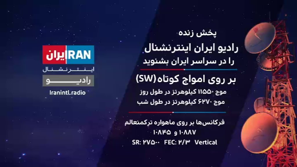

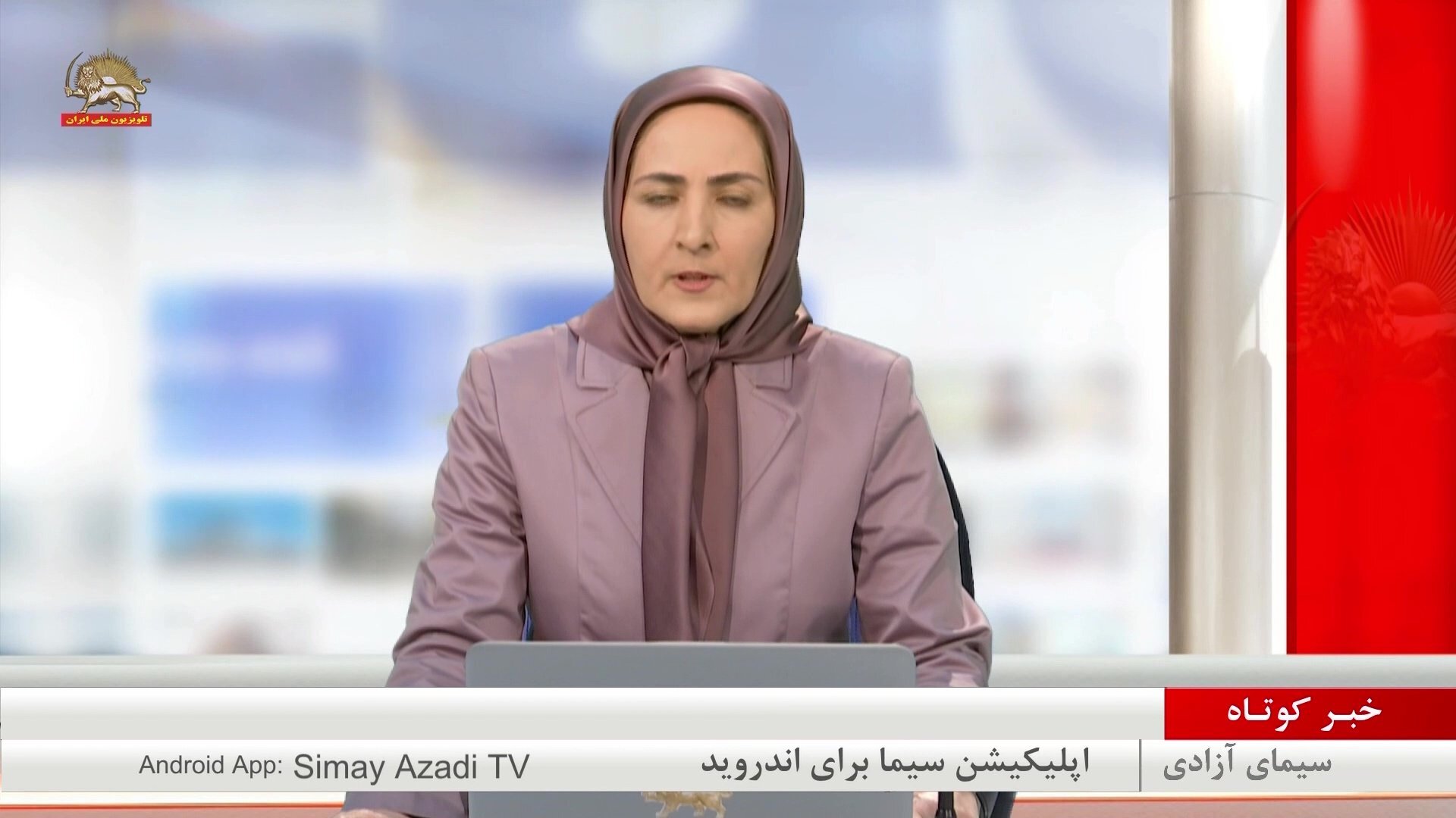

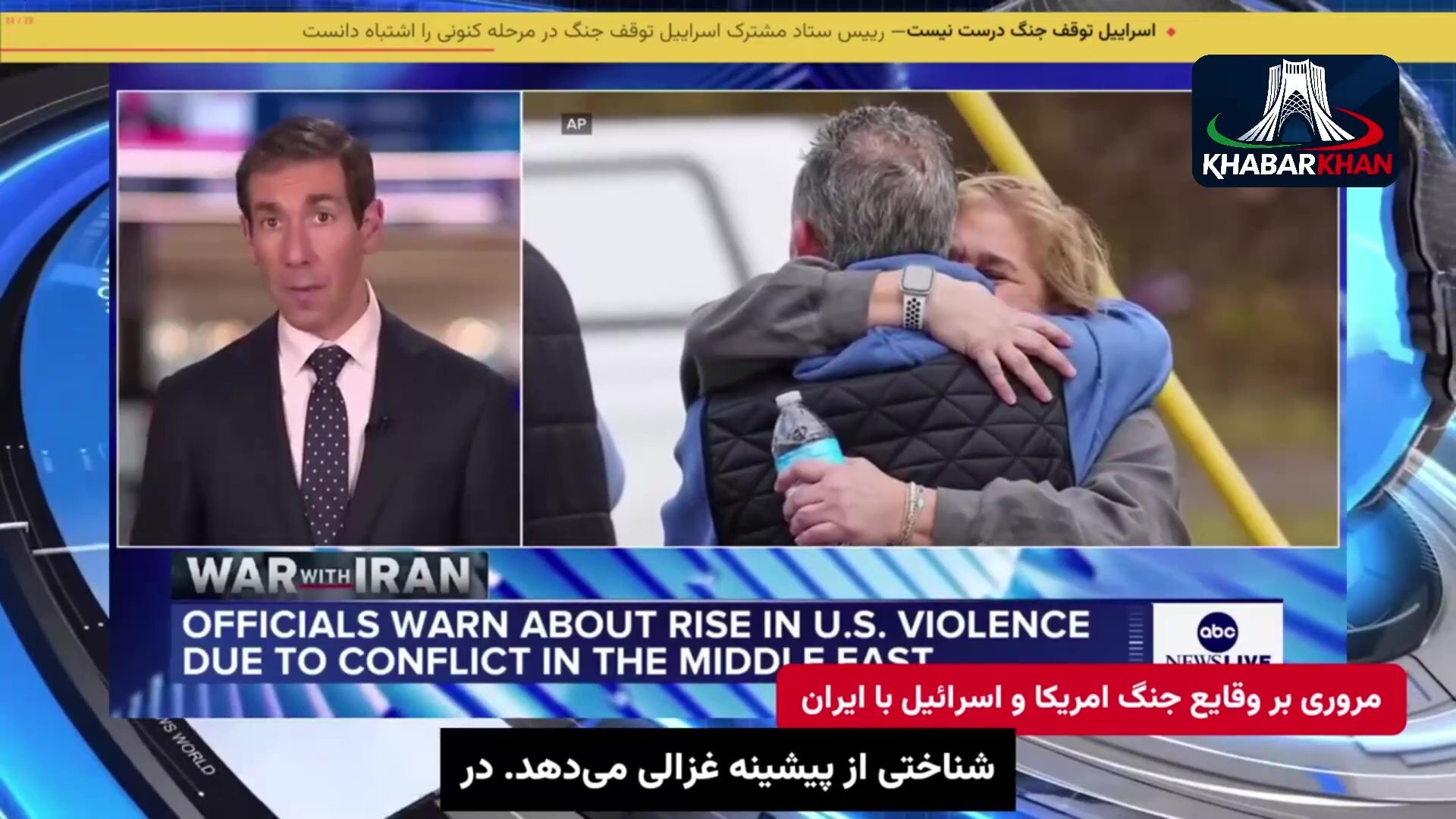

**TurkmenÄlem MonacoSat - 52°Oost: ** Audio Iran International 3x gestart:
11382 H 27500
11420 H 27500
10720 V 27500
11420 H 27500 Aut ID: No Name (Khabar Khan)

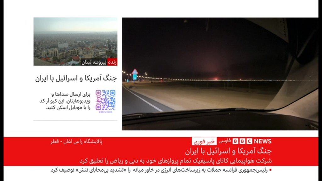

De situatie in Midden- en West-Europa normaliseerde zich na een nieuwe verbetering van de dekking op 21 maart.
“Simaye Azadi HD” is gestopt op 10.721 v 27.500 fec 2/3, 10.887 v 27.500 fec 2/3 en 11.382 h 27.500 fec 2/3
men is verder te ontvangen via de 11.421 h 27.500 fec 2/3 en 12.245 h 27.500 fec 1/2 DVB-S2 QPSK
“Woman TV” en Maah TV zijn gestopt op de 10.887 v 27.500 fec 2/3

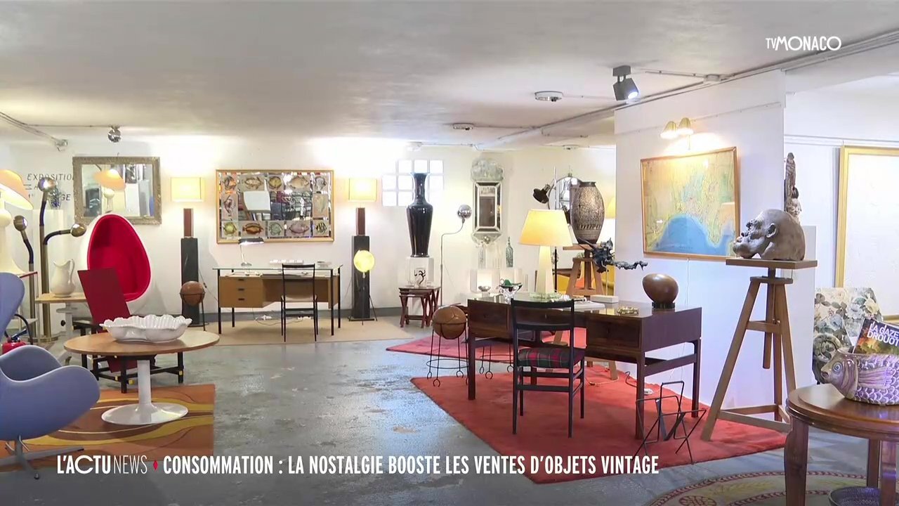

Name: “TV Monaco” Provider: “US Media CAST”
11421, H, 27500
52.0°E (0520 - TurkmenÄlem MonacoSat)
4:2:0 1280x720 50fps 1577kbps 16:9
NetwordID: 5478 TransponderID: 5478 ServiceID: 54
Video: 5401(H.264) Audio: 5402 - (AAC-ADTS)
PCR: 5401 PMT: 5400 Teletext: 0

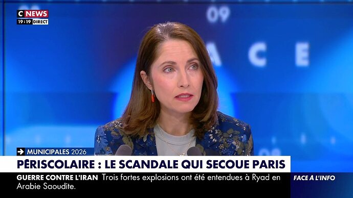

Name: “CNews” Provider: “US Media CAST”
11421, H, 27500
4:2:0 1280x720 50fps 1779kbps 16:9
NetwordID: 5478 TransponderID: 5478 ServiceID: 55
Video: 5501(H.264) Audio: 5502 - (AAC-ADTS)
PCR: 5501 PMT: 5500 Teletext: 0

“KhabarKhan TV” op de plek van “Iran National Revolution TV HD” op 10.721 v 27.500 fec 2/3 en 11.382 h 27.500 fec 2/3.
Name: “KhabarKhan TV” Provider: “WNS”
10721, V, 27500
4:2:0 1920x1080 25fps 1916kbps 16:9
NetwordID: 6478 TransponderID: 6478 ServiceID: 8
Video: 801(H.264) Audio: 802 - (AAC-ADTS)
PCR: 801 PMT: 800 Teletext: 0
11382, H, 27500
4:2:0 1920x1080 25fps 1912kbps 16:9

“Your Time TV” SD is gestopt via de 10.845 v 27.500 fec 2/3
men is verder te bekijken in HD via de 10.845 v 27.500 fec 2/3
“IRAN TODAY” is gestopt via de 10.887 v 27.500 fec 2/3.
“Iran National Revolution TV” SD is gestopt via de 12.245 h 27.500 fec 1/2 DVB-S2 QPSK
men is verder te bekijken in HD via de 12.245 h 27.500 fec 1/2 DVB-S2 QPSK
“IRAN INTERNATIONAL” SD is gestopt via de 10.845 v 27.500 fec 2/3, 10.721 v 27.500 fec 2/3, 11.382 h 27.500 fec 2/3 en 11.421 h 27.500 fec 2/3
“Audio Iran International” is vervangen door een “Promo” via de 10.845 v 27.500 fec 2/3
“Simaye Azadi SD” is gestopt via de 11.221 v 27.500 fec 2/3
men is nieuw te ontvangen via de 11.421 h 27.500 fec 2/3
Name: “Azadi TV SD” Provider: “US Media CAST”
11421, H, 27500
4:2:0 720x576 25fps 2057kbps 16:9
NetwordID: 5478 TransponderID: 5478 ServiceID: 59
Video: 5901 Audio: 5902 -
PCR: 5901 PMT: 5900 Teletext: 0
