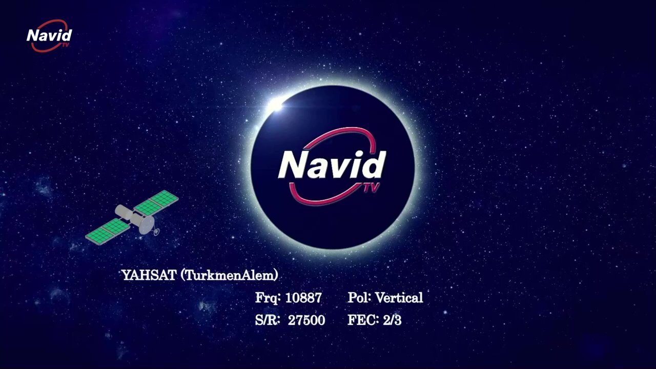

TurkmenÄlem MonacoSat - 52°E: 10887 V 27500 2/3 ID: Navid TV
