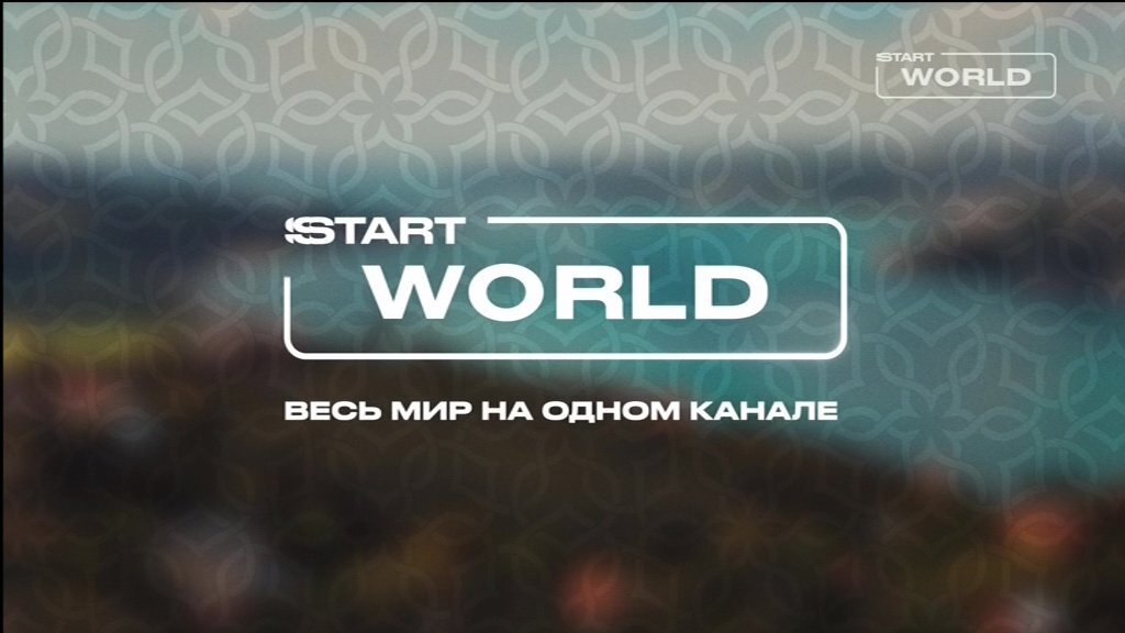

Türksat 6A - 42° Oost:
Name: “START WORLD” Provider: “TURKSAT”
11728, V, 27500 8PSK FEC 3/4
42.0°E (0420 - Türksat 3A/4A/5B/6A)
4:2:0 720x576 50fps 2485kbps 16:9
NetwordID: 1070 TransponderID: 60101 ServiceID: 17317
Video: 1217(H.264) Audio: 1317 -
PCR: 1217 PMT: 217 Teletext: 0

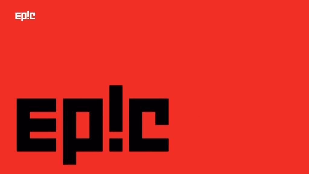

Name: “START EPIC” Provider: “TURKSAT”
4:2:0 720x576 50fps 2547kbps 16:9
NetwordID: 1070 TransponderID: 60101 ServiceID: 17315
Video: 1215(H.264) Audio: 1315 -
PCR: 1215 PMT: 215 Teletext: 0

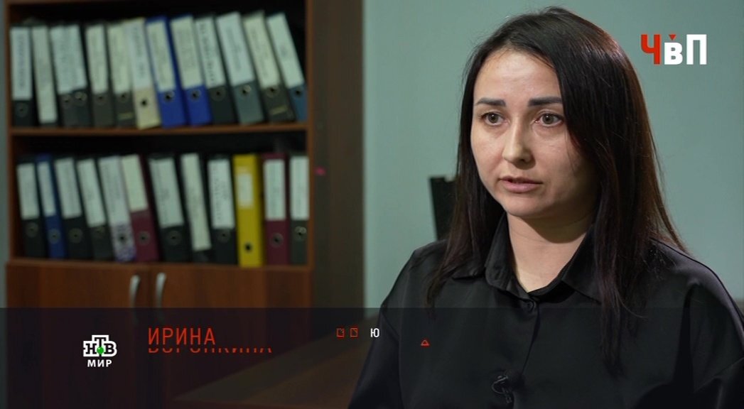

Express-AM6 - 53° Oost:
“NTV Mir” en de radiozenders nieuw via de 11.644 h 03.460 fec 3/4 DVB-S2 QPSK.
parallel naast de uitzending via de 11.457 h 03.460 fec 3/4 DVB-S2 QPSK
Name: “NTV Mir” Provider: “RSCC”
11644, H, 3460 NBC-QPSK FEC 3/4
53.0°E (0530 - Express-AM6)
4:2:0 720x576 25fps 2236kbps 16:9
Video: 201(H.264) Audio: 301 -
PCR: 201 PMT: 101 Teletext: 0
Name: “Radio CH50” Provider: “RSCC”
NetwordID: 1 TransponderID: 1 ServiceID: 12
Video: 0 Audio: 320 - rus
PCR: 8191 PMT: 120 Teletext: 0
